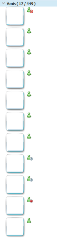

This is a more accurate version of roflmao456’s (remastered by Luis_Leandro) 2009 skin.
Most of the resources have been taken from WLM 2009 or modified to look similar.
Some off looking resources have also been fixed(like the status icons’ locations).

i’ll note out a suggestion to make it possibly as accurate as it gets:
try smoothing this out, instead of being a line right in this end, make it a gradient.
I don’t think that will work because that shadow is always there regardless of the dashboard toolbar design.
It’ll always look separated, and a gradient would make it look worse.
Made the dashboard toolbar lighter. It blends in with the top better now.
