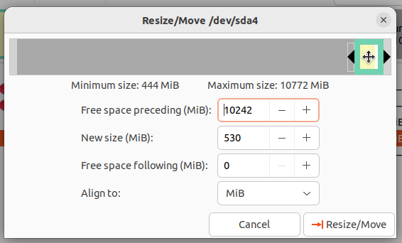

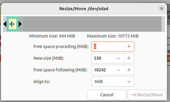

If asked to fix the partitions, choose the Fix button. Then find the recovery partition (probably /dev/sda4), right-click it in the list, and choose ‘Resize/Move’. In the resize window that comes up, drag the partition from the left to the right.
So from here:
To here:
Choose the Resize/Move button, then choose OK to the warning that appears. You should see an operation pending similar to Move /dev/sda4 to the right and shrink it from 530.00 MiB to 529.00 MiB. Next, choose the green checkmark Apply button in the toolbar, when the warning comes up, confirm by choosing the Apply button in the dialog.
