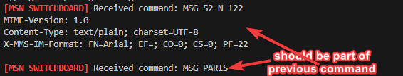

so basically with the way i handle multiline commands now there is a problem, i use a regex to check if the first three characters of the command to see if it corresponds to how a command would look, but this has caused problem when i send a message that corresponds to the regex of the command (for example starts with HEY or with a real command example MSG) because it checks that message line by line (separates using \r\n) and if the message isn’t a command it will just add it to the previous command in the parsed array
i’ve been stuck on this issue for a while now but it hasn’t become an actual issue that needs to be fixed asap until now, and i just can’t figure it out for some reason
here’s a screenshot that explains it a little simpler
i’m so so sorry if this is badly explained i’m really bad at explanations lmfao, if anyone can help i’d reallyyyy appreciate it ![]()

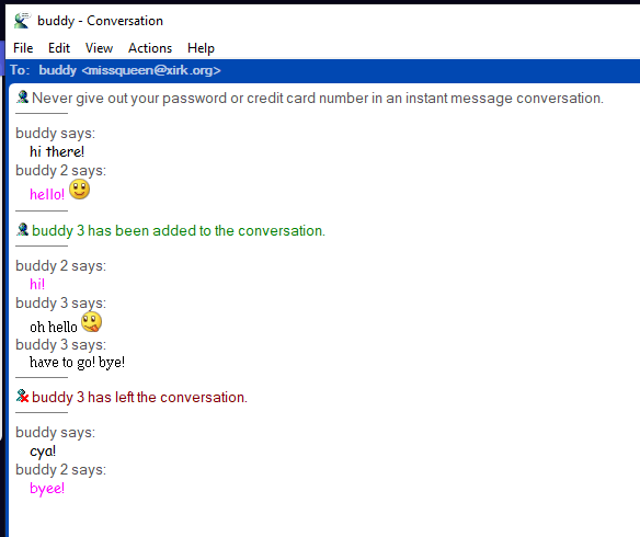

okay so first of all, i managed to fix the issue i had! switchboard doesn’t need a parser so i just removed it, and it works fine without it
and also pretty much all switchboard handlers have been made, which means pretty much all chat functions work now!
here’s a little demo ![]()

Usually for commands, I check if the first three bytes of the packet is a known payload commands, if it is, mark the last parameter before the CR-LF as a length and slice the next X bytes as the payload and send to the relevant parser, and any remaining bytes are sent back into the resolver. Same for multiple commands in one packet.
An example of such a table is below: (goes up to like MSNP13? i know P21+ has NFY/PUT which are payloads.)
This list should only care about client sent commands, not server!
Yes, some of these commands have server responses, but they aren't payloads!
For example: "GCF" to the server is non-payload, but the response is!
Another: "SDC" from the client is a payload, but the response is not!
Here is a list of currently known payload commands (only impl' Client and Shared!)
Client-only: QRY PAG PGD SDC UUN
Server-only: NOT IPG UBX GCF UBN
Shared : MSG UUX ADL RML
Note: Server UUX is technically a payload command, but always has length of 0.
An example of such a parser would be the one on hypothetic: MSN Messenger Protocol - Resources - FAQ

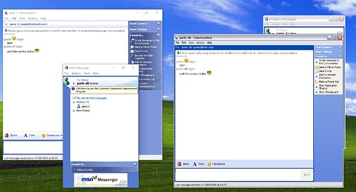

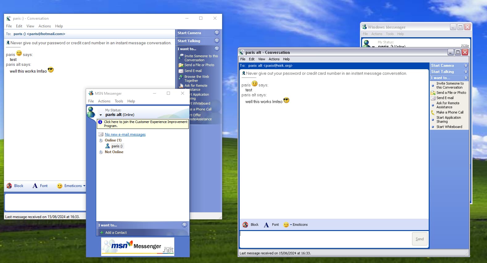

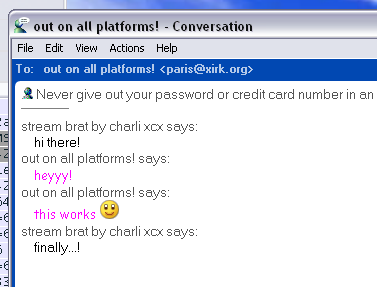

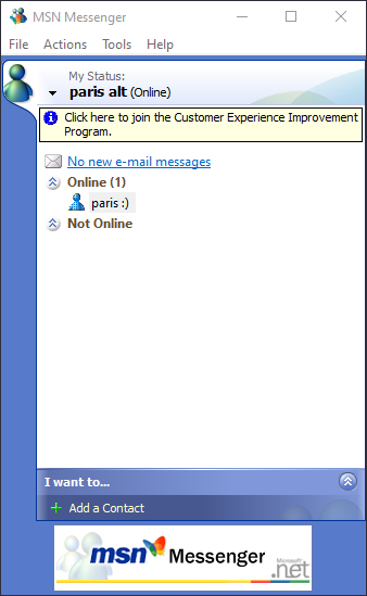

tweener authentication has been added which means msn 5.0 (and probably some higher versions, still have to try it out lol) now works!
here’s some screenshots of it in action ![]()
